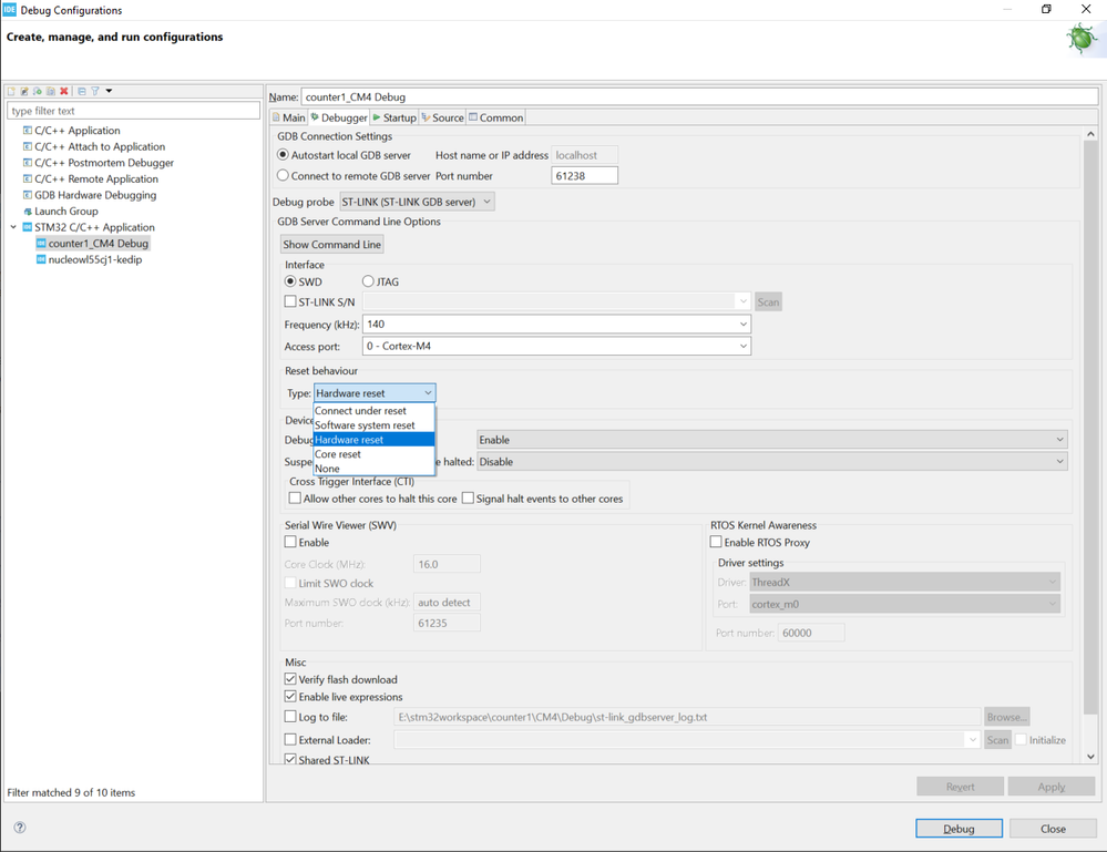

2022-11-24 10:21 PM
In my case, I get it to run by setting --> menu Run.Debug Configurations. Debugger:
1) connect to remote GDB Server Port Number change to not 61234 --> 61238, (while still chose Autostart local GDB server, Connect to remote GDB Server is not chosen, just change the number
2) Reset Behaviour: choose Hadware reset
Then it runs smoothly every time.. :) :), I really don't know what is the best/correct answer, just sharing my experience...
