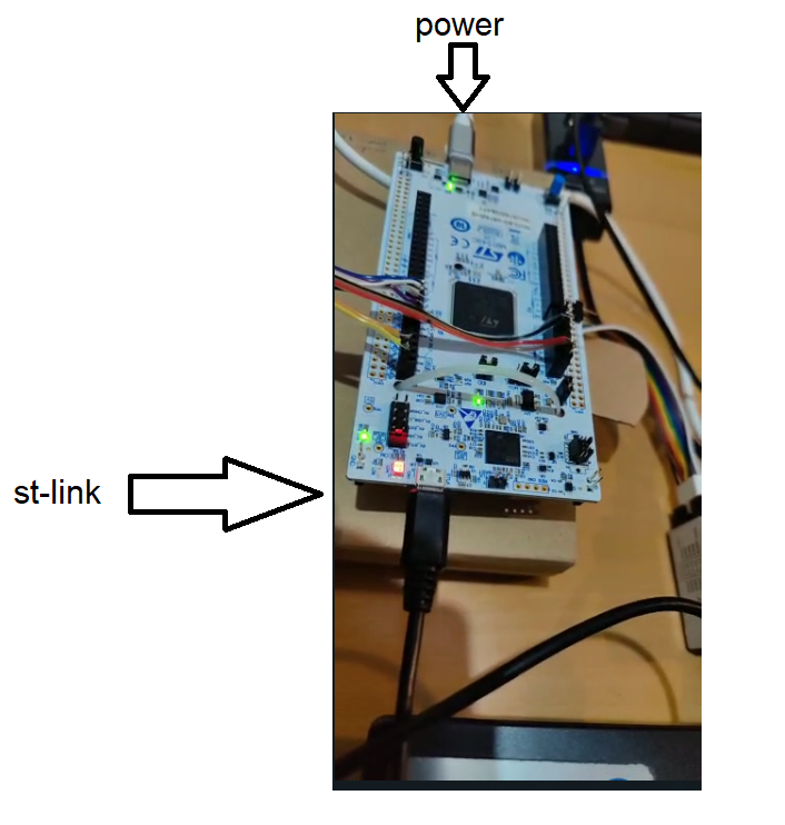

2021-12-12 7:13 AM
A picture of how I connected it
2021-12-12 7:15 AM
for some reason led 1 to 3 are blinking in order from 1 to 3
2021-12-12 7:16 AM
The debug tools are not super consistent. If STM32CubeProgrammer works, your hardware connection is fine.
Power cycle the board and try again. Try rebooting your system. Yes I know it's annoying.
There may be something STM32U5 specific here, but I also see odd behavior like this with other families occasionally in STM32CubeIDE.
2021-12-12 7:42 AM
Version CubeIDE ? GDBserver version? Try switch to othet debuger in IDE config, setup support for debug low power modes , connect under reset ...
2021-12-12 7:50 AM
boards is released with blinky project loaded
And for normal use with stlink power connect isnt necesary
Too your connected wires if use SWDIO pins can block Stlink to work.
