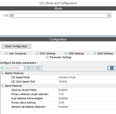

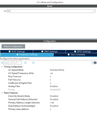

Master configuration:
Master code:

}Slave configuration:
Slave code:
