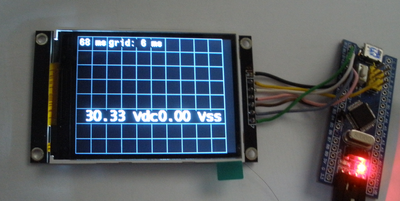

Then it might look like my ILI9341 TFT + F303 here:
