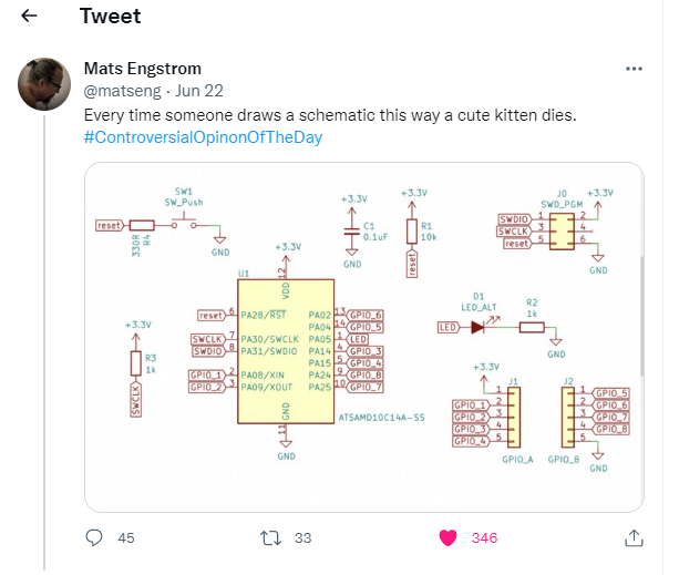

2022-06-23 1:18 AM
"I prefer beeping through the real circuit"
but, if the schematic doesn't show a connection to bleep, you're not going to know to bleep it ... ?
I think that's the trouble with these so-called "schematics" which are just a load of isolated blocks and show no connections.
:pouting_face:
https://twitter.com/matseng/status/1539519060106432513

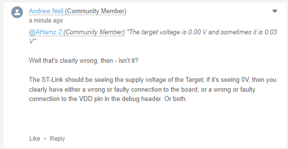

2022-06-23 1:40 AM
@AHamz.2 "The target voltage is 0.00 V and sometimes it is 0.03 V"
Well that's clearly wrong, then - isn't it?
The ST-Link should be seeing the supply voltage of the Target; if it's seeing 0V, then you clearly have either a wrong or faulty connection to the board, or a wrong or faulty connection to the VDD pin in the debug header. Or both.
EDIT
Oh, you don't have a Target voltage connection in your debug header.
That's wrong!

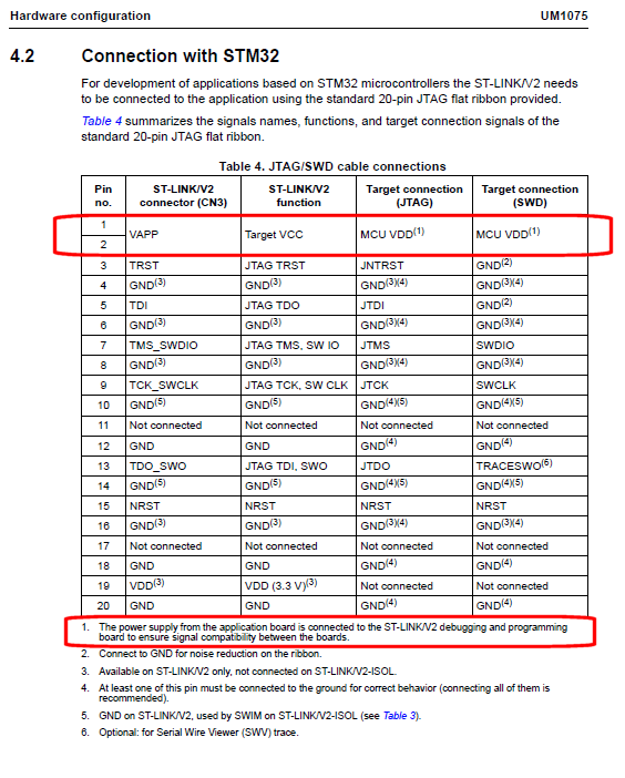

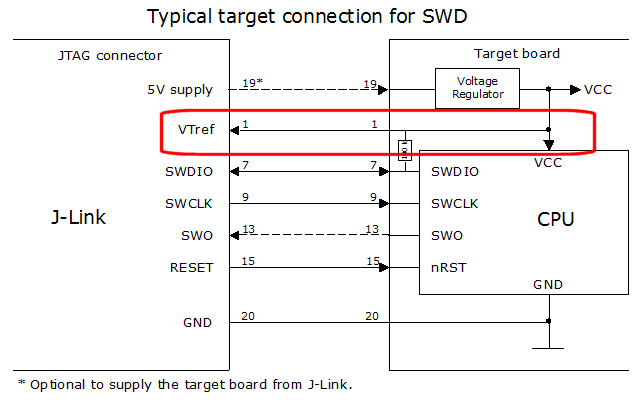

2022-06-23 1:57 AM
you need the Target Voltage connection to the ST-Link
As for any other debug probe; eg,
