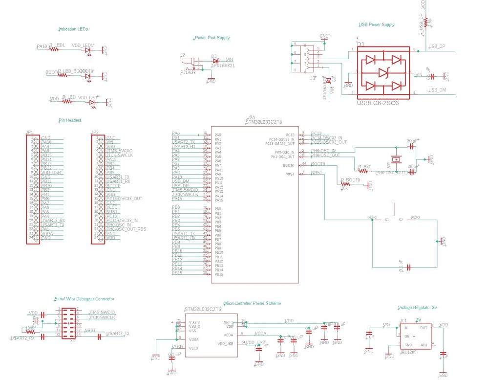

I have tested the microcontroller with different boards and all have the same problem.
I have noticed that the voltage across the NRST is 0V, which I think means that the microcontroller is damaged (There is no short circuit in the system).
I have connected the microcontroller to the PC through a serial wire debugger (using STLINK-V3MINI) and it says MC not found.
I have designed a custom board using STM32F4 before and I didn't have a problem before.
Do you have any tips to find the problem?
Thanks
Here is the Circuit design

Does the design have a schematic?
Obvious things to check would be part orientation, as placed,
pin designations, AVDD / AVSS connections.
2022-06-22 8:58 AM
I have just uploaded the schematic. Thanks.
What would be the difference between the two families in the case of the Circuit Design?
= VDDA/VSSA, are they properly connected?
(Also the VDD_USB, but that probably does not influence running as such)
2022-06-22 10:10 AM
If I'm not mistaken the VDDA net isn't connected to anything.
Lack of VDDA which powers the PLL and POR circuits, will clamp NRST to ground.
