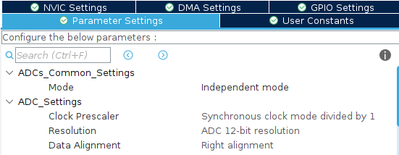

I have a couple of questions regarding the ADC clock on the board in the subject.
What is the default clock speed and where is the clock configured?
All I see in the documentation is that the clock is independent from the AHB clock, but I don't see where it is actually configured.
Also, the ClockPrescaler lets me choose between Synchronous and Asynchronous. What is the difference in this context. Is synchronous referring to the main system clock?

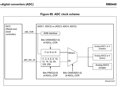

2024-04-12 8:44 AM
see rm:
Sync = to the AHB bus , its connected to; Async = the ADC clk in clock tree , you can set.
You should see in CubeMX, what you choose. :)
