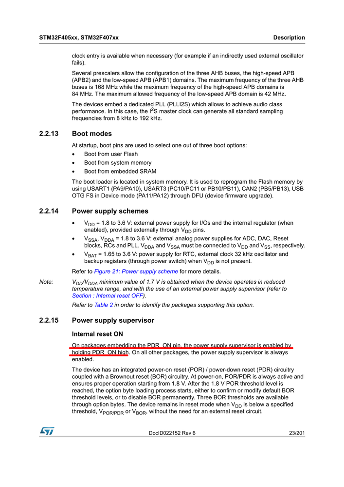

Connect it to VDD if you want to use the internal reset circuitry. If VDD never drops below 1.8V, ie. in most of the cases, you most probably want to use this option, and forget about AN4488 etc.
Only if you want to use the 1.7V-1.8V VDD range (at limited temperature range) you need to connect PDR_ON to external supervisor.

You can't use PDR_ON as a general-purpose IO. You don't need to connect a series resistor.
