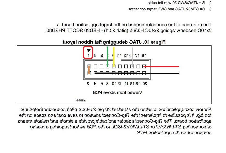

i connected st link to my stm32 on customboard ,
1 pin -> 3.3V, 7 pin -> SWDIO, 9 pin -> SWCLK, 15 pin-> NRST, 19 pin -> GND.
but keil doesn't recognize mcu.
I attach the image of the connection .
st link was damaged or wrong pin configuration?
thank you. i want to resolve this issue.
Thank you in advance

You don t need rst.
3.3v is adc monitoring input for stlink, not a supply to the target .micro.
Did you check pin1 of stm32 on your board? Which stm32?

Strikes me that you have the pin orientation completely backward.

I measured the voltage of pins. it appears vcc is 3.28 v. so i think i connected correctly.
2019-06-21 12:06 AM
Ok then perhaps you can enumerate your colour scheme, because the RED wire in the ribbon cable is PIN1, and the connector is a mirror image of the pins in the ST-LINK header it plugs into.

Perhaps a diagram might help penetrate your cranium?
