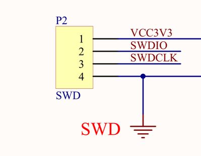

I recently bought a Blue Pill, STLINK-V3MINIE and an adapter. How do I connect them together correctly?
2025-03-23 3:54 AM - edited 2025-03-23 3:55 AM
Dear @hafiqat_ ,
You need just to connect/hook the SWD connector signals from the ST-link to the target : VDD, Ground , SWD and CLK
Hope it helps you , pay attention on the orientation of the cable to not Have short circuit on both VDD/Ground .
STOne-32
2025-03-23 7:45 AM
Do I just need to solder the contacts to the stlink? Without using an adapter?
2025-03-23 7:54 AM
Yes you can for development purposes .
2025-03-23 9:08 AM
Where to solder SWDIO?
2025-03-25 2:34 PM
ST-Link +-----------+ | | | Vtarget +<-------------------------+-----VDD | | | | | | | | +-----+-----+ | | | | | SWDIO +<------------------>+SWDIO | | | | | STM32 Target | SWCLK +------------------->+SWCLK | | | | |
| NRST +------------------->+NRST |
| | | | | | +-----+-----+ | | | | | | | GND +--------------------------+-----GND | | +-----------+
