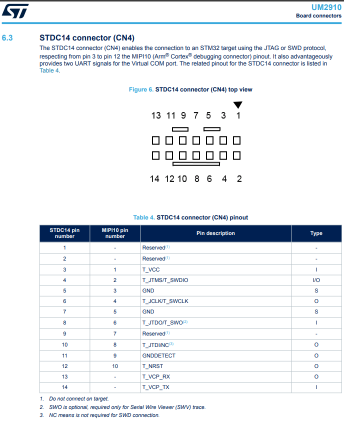

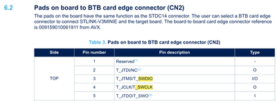

> SWDIO with ?
SWDIO should be connected to pin 3, "TMS".

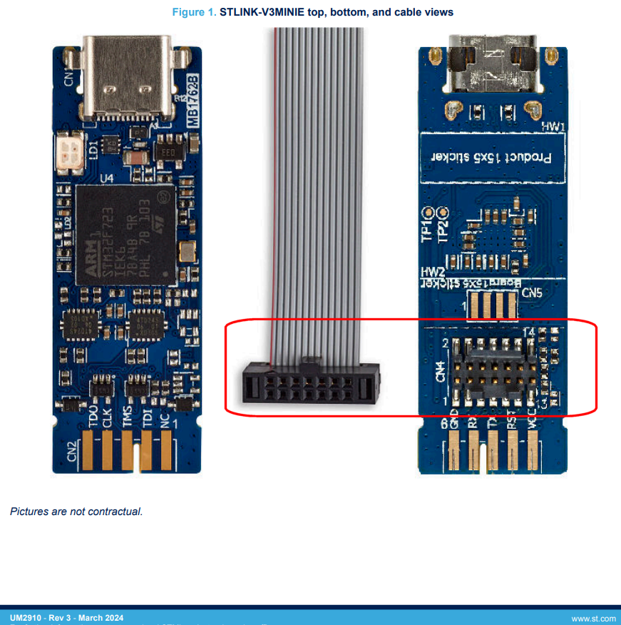

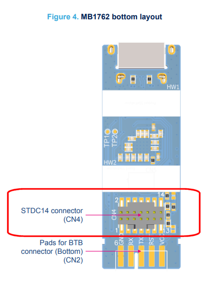

> Using CN4 and a cable to a header on the board is the most common and often the best method.
I don't understand what CN4 is. Is it some kind of adapter? If so, what does it look like?
2025-03-25 2:00 PM
Again, see the User Manual:
It's a 14-pin header which mates with a standard ribbon cable.
