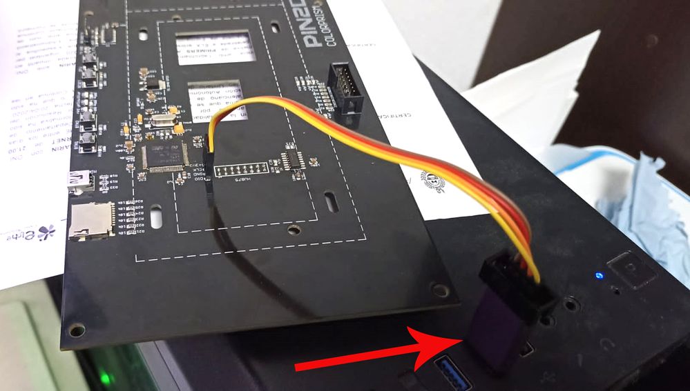

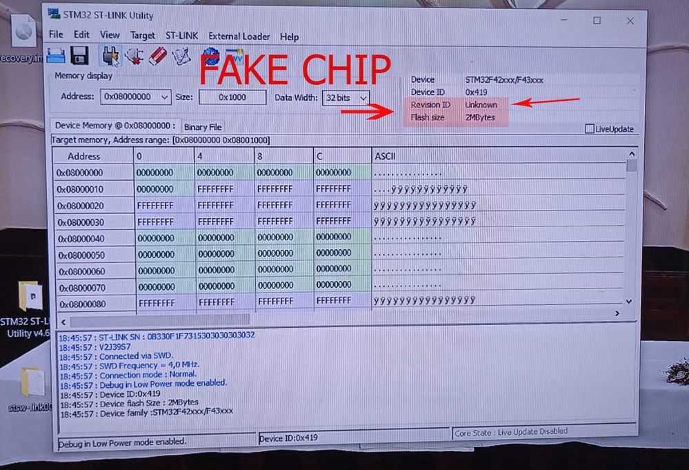

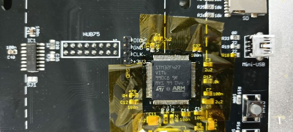

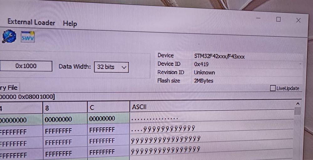

This is the second time it has happened to me. Some people talk about "Fake Chips". How to know if my STM32 Chips are Fake?

Primary your foto with red arrow isnt DFU
2.colors wires isnt right, i have similar proggramer and GND pin is middle
3.use SWD connected utility and check your chip normal way
