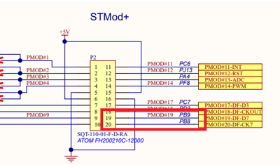

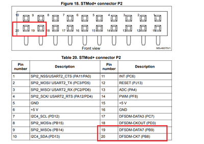

The only solution for FDCAN1 usage on this board is to use STMOD+ connector where PB8 (FDCAN1_Rx) and PB9 (FDCAN1_Tx) are available on pins 19 and 20. From the board's user manual UM2411:
From the board's schematic:
Unfortunately, FDCAN2 is not an alternative as all the pins are already used externally by some hardware.
Hope that answers your question.
