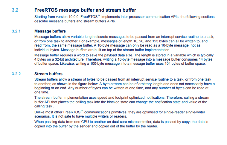

Almost the same question asked in this post: How can I bridge between two cores in STM32H745 to share data?
As you are using FreeRTOS, from the AN5617: the usage of stream buffer/message buffer in FreeRTOS context:
