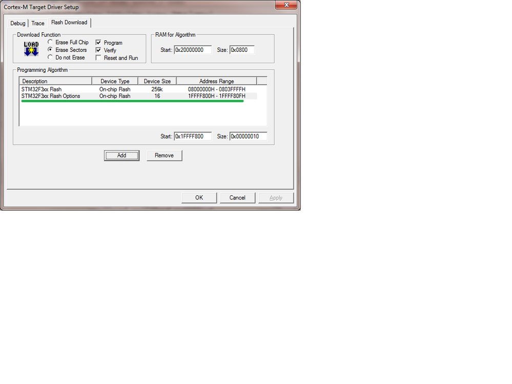

I'd pay attention to what the NRST pin is doing, and what you have going on in your firmware early in the boot/reset sequence. Wrestling a processor to a stop initially is a key part of the task. It is also not necessary to rely on SWD/JTAG tools to program option bytes, these are things you can initialize or change from within your own application code, or boot loader. Keil allows you to select a programming algorithm for the debugger which is agnostic to which pod you are using.We’re moving the ST Community to a new platform to give you a better and more reliable community experience.
