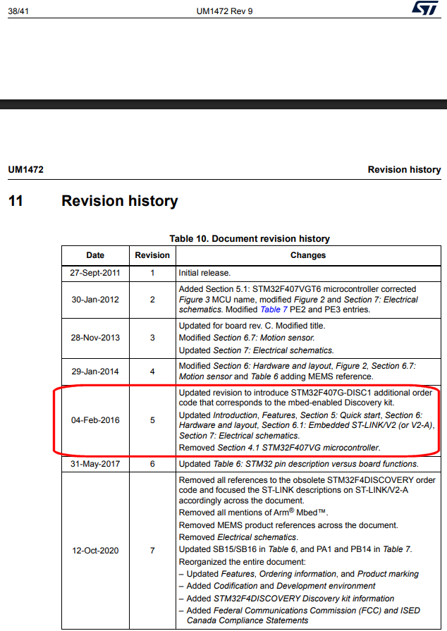

Hello @dheerajpk and welcome to the community;
The new order code STM32F407G-DISC1 replaces STM32F4DISCOVERY.
The STM32F407G-DISC1 with ST-LINK/V2-A replaces the obsolete STM32F4DISCOVERY order code with ST-LINK/V2.
For more information; I Recommend you to look at Discovery kit with STM32F407VG MCU - User manual section 8.2 STM32F4DISCOVERY product history.
Thank you.

Yes, they are one and the same.
https://www.st.com/en/evaluation-tools/stm32f4discovery.html
Are they?
Didn't the original one not have the VCP in the ST-Link?
