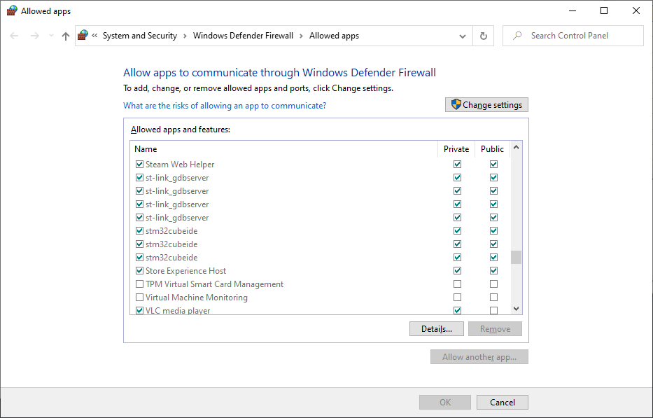

I just found this thread - I had the same problem.
What worked for me was to allow st-link gdb server and stm32cube IDE in Windows Firewall. If the network access is denied, the USB device can't be detected in Windows.
