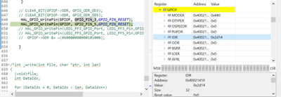

This is the overview in SFR:
MODER and IDR have a value.
2024-01-06 9:58 AM - edited 2024-01-06 9:59 AM
IDR is input data..
MODER looks ok, 440 = pin 3+5 -> output. ODR = 0, outputs lo.
LEDs on ? check voltage at pins 14+16 , with and without your plug connected.
