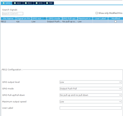

2024-01-06 6:16 AM - edited 2024-01-06 6:20 AM
To drive the pin low, just define it as a output , then set this low.
( here pb12 , just to show )
HAL_GPIO_WritePin(GPIOF, GPIO_PIN_3, GPIO_PIN_RESET); // LED ON

2024-01-06 6:57 AM
So try : set in cubeMX (-> xx.ioc) GPIO pin as output and at low level.
-> generate code , -> compile , -> debug --- and led is on. If not : your on the wrong pin (number or name).

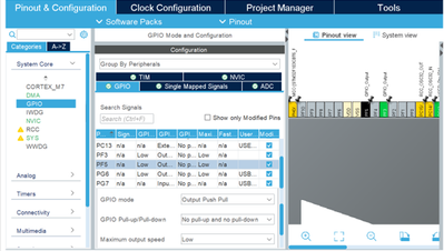

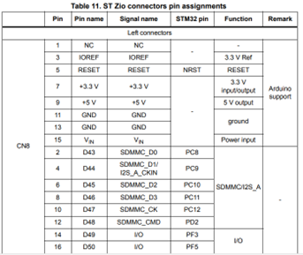

2024-01-06 8:10 AM - edited 2024-01-06 8:13 AM
I did exactly the same. I'm using pin 14 and pin 16. On stm32 are the PF3 and PF5. I'm still measuring 1.9V voltage at the cathode.
