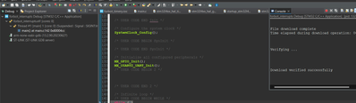

I wrote a simple program using interrupts:
Turns on the LD2 the diode if signs "O", "N" and enter are received respectively, turns off if "O", "F", "F" and enter are received otherwise (Im passing only the parts where I made changes :(

/* USER CODE END 0 */Unfortunately, as it is shown in the picture up, the debugger is not entering the interrupt code part and I don't know why
2025-05-08 9:56 AM - edited 2025-05-08 9:56 AM
What board are you using?
Before getting into interrupts, have you checked that you can received characters using simple polling?
Can you transmit OK?
@MichalPorazko wrote:as it is shown in the picture up, the debugger is not entering the interrupt code part and I don't know why
All that picture shows is that you weren't in the interrupt at the time you took the screenshot.
The code you posted doesn't show anything which enables interrupts.
Please post a minimum but complete example which illustrates the issue.
Have you tried one of the standard ST examples?

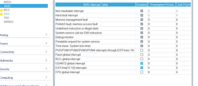

}I have enabled the interrupt

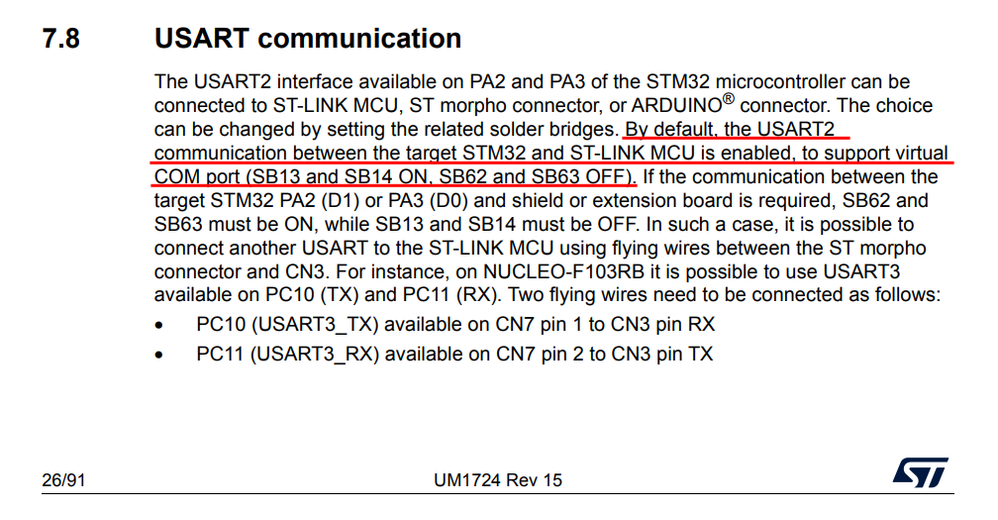

2025-05-12 1:51 AM
You forgot the source code formatting!
@MichalPorazko wrote:Board: NUCLEO-L476RG
So are you using the on-board ST-Link's VCP (Virtual COM Port) for sending & receiving?
This does use USART2 by default - so be sure that you (or any previous users of this board) haven't changed any links. Also that no "shield" is connected which uses these pins:
