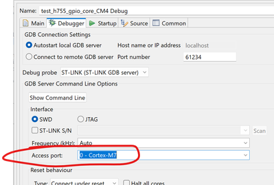

In the debug configuration, are you connecting to AP0?
Can you connect with STM32CubeProgrammer?
2025-03-17 9:37 AM
Yes, I am doing that

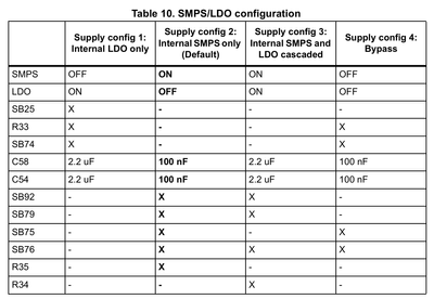

I recently purchased 2 NUCLEO-H755ZI-Q and both of them will not boot. ST has problems. In UM2408 Rev 6 it says the default power configuration is DIRECT SMPS but a quick scan of the board shows SB92, SB75, SB79, SB76 and R35 are INSTALLED. This is in direct contrast to what UM2408 describes in section 7.4.8 as the defaults for DIRECT_SMPS. The board did not come configured for DIRECT_SMPS.
I'm not seeing a contradiction here. "X" means installed. "-" means not installed.
"Internal SMPS only" and "Direct SMPS" are the same. The core is powered directly from the SMPS.

2025-05-09 10:48 AM
I have come to that conclusion. X means installed. It took quite a few iterations of attempt to program, no device detected. BOOT0 high, erase FLASH and reprogram ... then it suddenly started working. Why I had to go through that is a complete unknown but I did go through this to a lesser degree with an H747-DISCO also.
