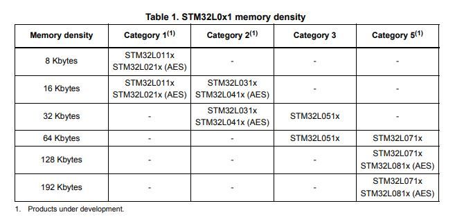

Also, datasheet says that nBOOT_SEL bit available only for Category 1 devices.
Again, according to datasheet, STM32L011F4 is category 1 device:

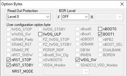

The problem is that I can not program nBOOT_SEL bit using ST-LINK UTILITY, it is shown in gray color and I can not check/uncheck it.
What could be the problem?

Try the STM32 Cube Programmer, it is the software they have migrated too.
2 REPLIES 2

STM32 Cube Programmer works fine, thank you very much.
