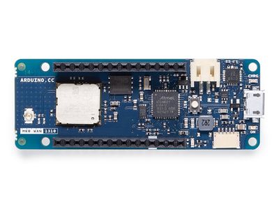

@Tesla DeLorean points to the MKRWANFWUpdate_standalone as a Host for FW updates using the System Bootloader.
Also here.
Seems to be based on stm32flash: https://github.com/stm32duino/stm32flash
Andrew Neil
Super User
@LCE wrote:
  1. Anybody using the ST bootloaders in some real-life products ?
So, from the above, it seems that Arduino have used it in their MKR WAN 1300:
https://docs.arduino.cc/hardware/mkr-wan-1300/
