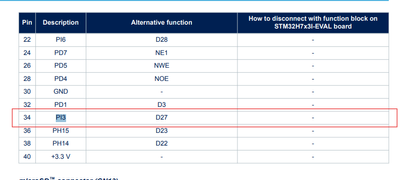

In the STM32H753xI(MCU) datasheet(https://www.st.com/resource/en/datasheet/stm32h753vi.pdf) the pins PI2, PI3 provide the functionality for SPI2_MISO and SPI2_MOSI respectively. But in the STM32H7-MB1246- E03 EVAL board schematic(https://www.st.com/...
