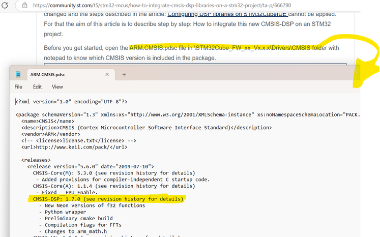

I think I found the answer to my own questions. The CMSIS version distributed with H7 is defined as instructed here:
So it turns out that the DSP library is very old indeed, evidently the missing functions have been added at a later stage, the current version being 1.16.2.
