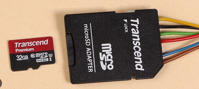

For testing just use a sd-card adapter with soldered wires; i always do it this way;
anyway wires should be max. 30 mm long;
2025-07-24 1:29 PM
Oh wow, I didn't know that that worked. Well I might try that later on if this still doesn't work, but I would love to get this working with SPI if possible.
