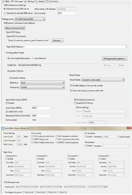

I have overall found this feature to be very unreliable, for reasons unknown. The data comes out OK from PB3 and goes all the way to the STLINK V3, at the expected speed, 1MHz, but Cube IDE displays nothing. I have this across a number of development units. Sometimes it works and then stops...
Anyway, digging into this, it looks like the entire trace macrocell is configured via the debugger when (or before) reset is released from the target. That is why none of the STM example code sets up any of this stuff. I also managed, years ago, to get SWV working not with Cube IDE but with the STM32 STLINK Utility, which presumably does the same via-debugger config tricks.
Also just because you see 1MHz stuff on the scope doesn't mean that it is in the right format for Cube IDE to decode it.
So I went looking for how to get this stuff configured in software in the target. Obviously any such config will override the Cube/debugger config so you will have to make sure Cube IDE's config matches exactly if you still want that to work. And after a lot of work I found the following, and wonder whether it is complete:

Again - are you using the ST own branch of OpenOCD? If you do, you could request support from ST. Of course a small, reproducible project for a well known board and clear description will be helpful.
2025-10-03 3:06 AM - edited 2025-10-03 3:08 AM
This works for SWO ITM, STLINK V3, OpenOCD mode
PC Sampling is just super dodgy.
The thread title needs editing. There is NO way to do it. The SWV ITM debug uses a complicated encoding; it is not any kind of simple UART.
2025-10-03 1:15 PM
"Again - are you using the ST own branch of OpenOCD? "
Yes.
It works a lot better than the GDB Server mode, although the latter has worked fine for normal program upload and breakpoint debugging.
