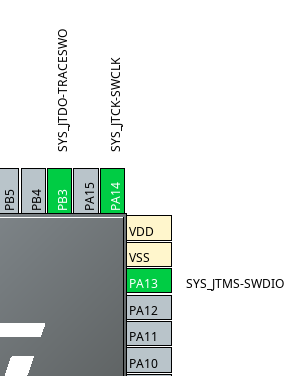

Sure, if you use the pins for anything , debug is gone.
Its first on a setup for the cpu pins, to define the pins for debug - if you want debug at all.
No configuration needed, they work at reset already; just do not touch them. :)
Read and see in ds, pin descriptions , pin definitions at start/reset,
or just see in Cube -> pinout view, set debug or trace and you see the needed pins:
(on F103 in pic)

2025-10-05 11:08 AM - edited 2025-10-05 11:12 AM
(on F103 in pic)
