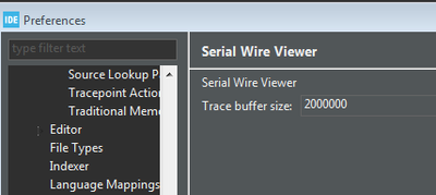

I already have a huge buffer set there.

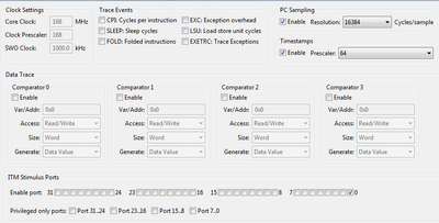

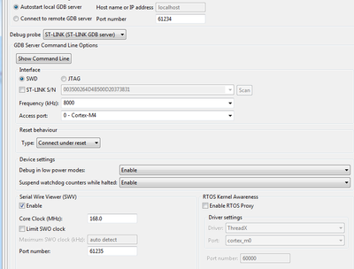

Can you or anyone check if SWV ITM works with PC Sampling enabled and, if yes, post screenshots of config?

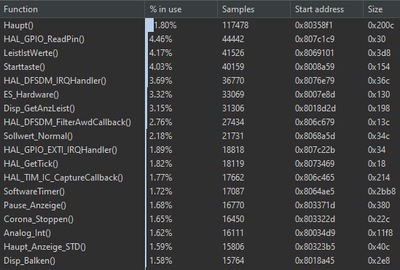

Yes, as i said: working fine, see here example for profiling: maybe one minute running (top part...> 1%)

The buffer is set to 20MB.

+ set prescaler :because SWV is in the end a serial, at 2 or ...8 mbit , so it cannot send sampling time info at a rate of 100 MHz or so...i have prescaler set to 64 or more...at 200MHz core speed.
Buffer i have also at 20MB for profiling.
>How do you set the address range for profiling?
Huh, what? Profiling just gives you the time/function in % , = how long is cpu busy in ...,...,...;
no address range, just all, what its doing, while sampling.

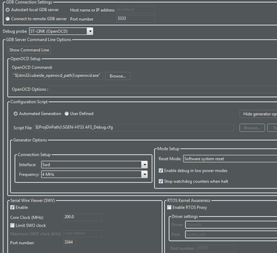

What settings do you have here?
2025-10-01 6:34 AM
...about same (just other cpu , H743 H7A3 , clock etc. );
and debug (mostly i use OCD ) software reset:
uncheck PC sampling, if not looking for statistics.
