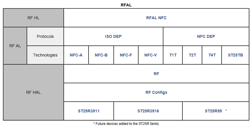

Got a better idea of it from the below picture of RFAL documentation.
For my case, RFAL NFC - ISO DEP - NFCV - to ST25R3911.
