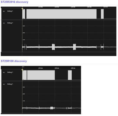

  • Yes, I observe an RF Filed, as soon as I start the discovery procedure (see image below)

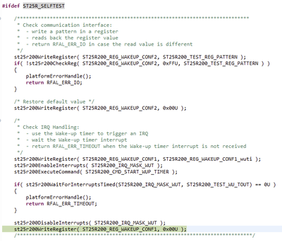

Ok... I've enabled ST25R_SELFTEST (first taught that's kind of a chip testmode, but its additional testcode which is part of the st25rx specific RFAL).
That Test runs through without any error...

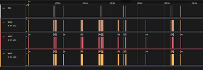

I've now captured the SPI communication and IRQ pin... (didn't yet try to analyze it... I'll do now)
Many thanks for your support.
Best, Stefan

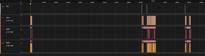

Stef2
Associate III
Here it is...
Stef2
Associate III
Maybe HEX format is better...
just provide the .sal file
Ok...
