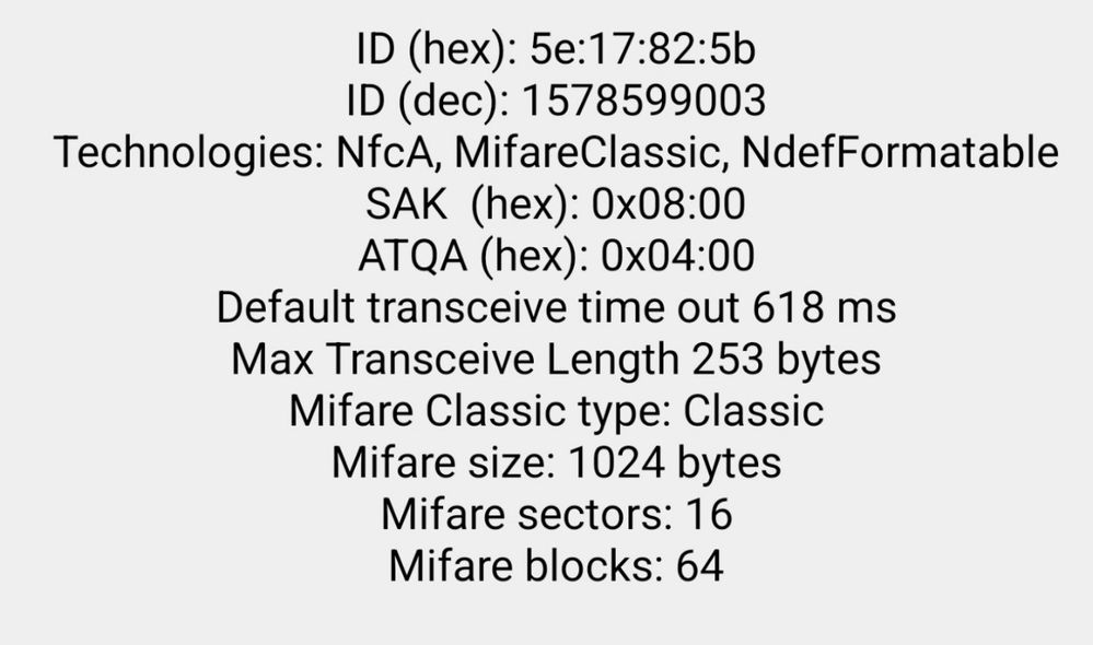

2022-11-10 1:58 AM
2022-11-10 2:31 AM

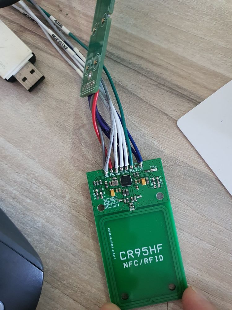

I guess you are using a Mifare classic tag. For your information, reading block 0 after cascade level 1 anti-collision in such tags is only possible for UIDF1 personnalization. This was my rational for asking more information about the tag (model/manufacturer/personalization). Feel free also to share details about your hardware setup: do you use a custom board or a ST board (X-NUCLEO-NFC03A1 or M1054B transceiver board) or other ST board?
Regarding the library, for new projects we recommend to use our RFAL which provides a common API for the various ST25R readers (see ST25 embedded NFC library).
Rgds
BT
2022-11-10 5:20 PM
yes, i have use mifare classic and this board connect to STM32F103C6T6
because flash capacity of stm32f10c6t6 is small so i need more optimized library
after i remove remove reserved bytes the result is as follows (read block 1)

2022-11-11 2:30 AM
you seem not be aware of UIDF1. So likely the card is not personalized that way. Also reading block 1 will not work without cryptography and mutual authentication using crypto1.
ST does not provide code for supporting MifareClassic cryptography.
Please also see https://community.st.com/s/question/0D53W000014zGpESAU/st25r95-data-read-and-write-problem-iso1443a
Best Regards, Ulysses

2022-11-11 5:37 PM
i see. but i don't see any way to send MifareClassic cryptography.
I'm having a hard time finding documentation to solve this problem
thanks for reply
2022-11-11 5:37 PM
i used ST25TN card but i need to integrate different cards
thanks for reply
