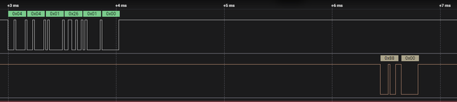

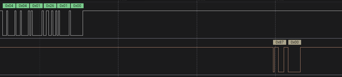

Then we start polling the device to check if there is any tag or not:
uint8_t commandDETECT[] = {0x04, 0x04, 0x01, 0x26, 0x01, 00};
When there is no tag placed near the CR95HF we get the 0x87 response as expected.
But when we place the ST25DV discovery tag next to the antenna we should expect a response with UID.
But all we get is response 0x88. This is a SOF error. What could be the cause of this error?

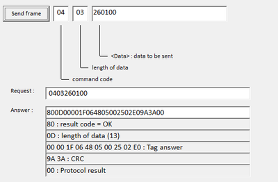

The Inventory command ("commandDETECT") is incorrect. It should be 0x04 0x03 0x26 0x01 0x00:

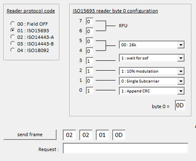

I would also suggest to change the protocolSelect command in the following way:

Hi Brian,
Thank you for your answer. We now receive the UID as expected.
