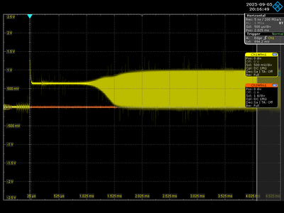

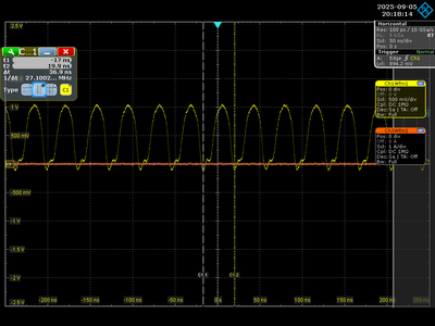

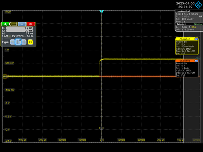

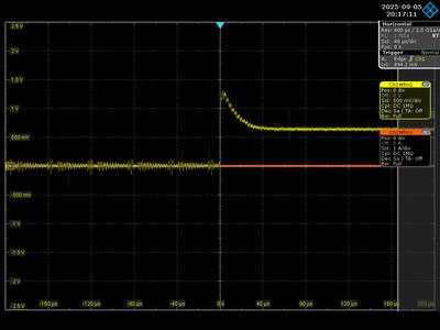

On an oscilloscope, I can see that the XOUT pin that goes to the crystal rises to just above 0.5V on powerup, but the crystal never begins oscillation (see attached image). I am using the XRCGB27M120F3M00R0 from Murata, which is 27.12MHz with ~150 ohm ESR and 6pF load capacitance. I will provide the schematic for the entire circuit for reference.

Thank you everyone for the attention on this. Unfortunately the solution was not very interesting (and rather frustrating) -- the footprint of the crystal was made backwards, so the pinout was swapped. Schematic is good, but the layout was wrong. So, what I was seeing was just the excitation voltage passing straight through to the other pad because it was going through the ground plane of the crystal...

startup on the working project's board
transient startup response on working board
oscillation on working board
startup on not-working project's board with the same crystal from the working project.

On the last scope trace (non-working board), the time constant appears to be too large. Could you check the C55 and C56 capacitors for the correct 6 pF value, proper soldering, and other potential issues?
