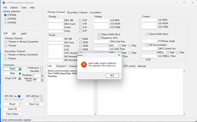

I tried to connect the EVAL-STPM32 board to the STPM3x Evaluation Software but encountered the following error when trying to read data.
Error message: 'Read buffer length insufficient. The operation has timed out.'
PC was running Windows 7 STPM3x Evaluation Software v3.1.0.0

Hey i have also faced same problem. Could you make any progress about it?
2024-09-24 1:40 AM
Hi, did you manage to solve it? I have the same issue

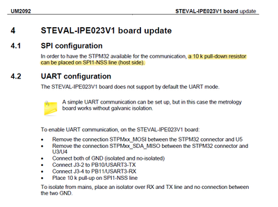

: solved one of similar issues, 10 k pull-up at UM2092.
