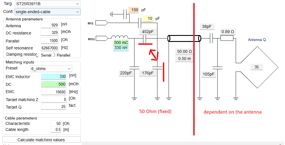

2026-03-10 6:22 AM - edited 2026-03-11 12:51 AM
Hello qwdwdwwq,
I think you have mixed up some components of the matching network.
Do not seem to be correct.
Please see attached the proposed matching network in the antenna matching tool:

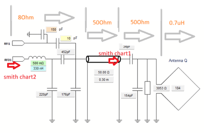

The left side of the sma cable is fixed since it matches 8Ohm to 50Ohm. The right side of the matching network is dependent on the antenna parameter. It matches the antenna (inductance) to 50Ohm.
q1: Not sure about q-multiplication, but yes, in general the antenna voltage is 5-15 times higher than the RFO output.
q2: Please have a look at the single ended application note (AN5592)
q3: Yes, this is why per default a capacitive voltage divider of 10:150 is proposed.
q4: I think you have wrong matching values applied. Can you please share a smith chart of your antenna matching?
BR Travis

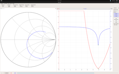

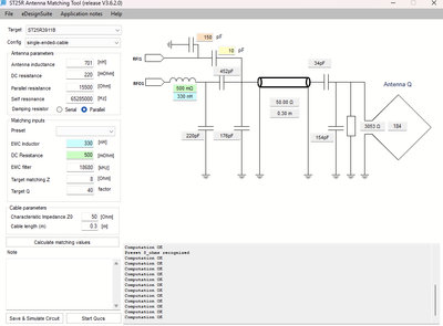

2026-03-11 1:24 AM
Hello Travis,
Thanks for help,
Here is the last smith chart, measured with the cable:
And also last tool output, im not sure about those and will double check if the actual soldered caps match this:
2026-03-11 1:35 AM
Hello qwdwdwwq,
Many thanks for sharing the smith chart measurement (smith chart1).
It confirms that your antenna is correctly matched to 50Ohm.
Can you also share the smith chart of the complete matching (smith chart 2)?
BR Travis

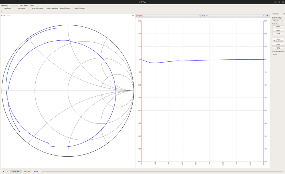

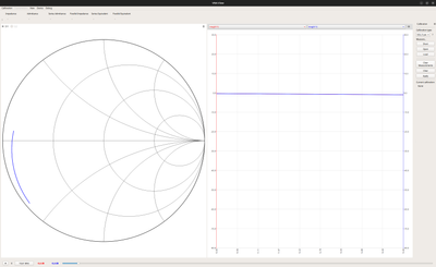

2026-03-11 2:19 AM
I took a screenshot of smith chart 2
2026-03-11 3:30 AM
Hi again,
unfortunately the 13.56MHz marker is missing.
Maybe can you also increase the span? There is no resonance visible.
BR Travis

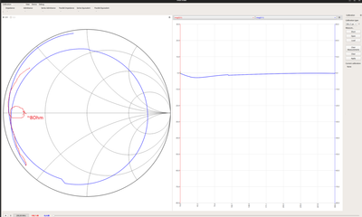

2026-03-11 3:34 AM
Sorry, I increased the span to 250Mhz
2026-03-11 3:38 AM
Your smith chart tells me, that the series and parallel cap does not fit.
The circle should look like this: (red curve)
BR Travis
2026-03-11 3:55 AM
Do you have some guidance on how to tune this? its way off from what the tool calculated
Thanks
