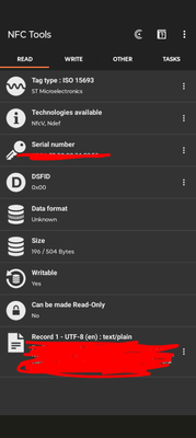

}NFC-Tag:
- ISO 15693
- NfcV, Ndef technology
- 196 Bytes of data

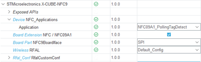

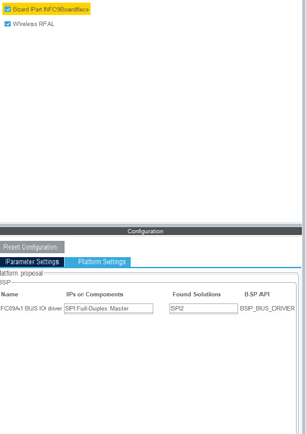

you have probably downloaded the X-CUBE-NFC9 package and have used STM32CubeMx to generate the code (standalone version or embedded in STM32CubeIDE).
Make sure to follow the step by step Getting Started (in <homeDir>\STM32Cube\Repository\Packs\STMicroelectronics\X-CUBE-NFC9\1.0.0\Documentation)
In particular, Sofware Packs / Select Components:
and in Middleware:
then the nfc_conf.h file should be properly generated.
Note: as of today the X-CUBE-NFC9 does not include the NDEF middleware. You can retrieve this middleware from the ST25 Embedded Library as well as the ndef demo application from the ndef_rw demo project.

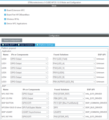

A Problem I do encounter is when generating code, I get this error in nfc_conf.h

The checkbox is also yellow, but it doesn't give a warning message something is wrong.
I have: STM32CubeIDE Version: 1.19.0
Do you know a solution for this problem?

Should I need the Ndef, because it also has NfcV (screenshot)?

Hi William,
The ST25 Embedded Library is a collection of source code provided in a self-extracting archive with a click-through license. The archive does not install any drivers, DLLs, or EXEs; it only copies source and project files into a specified folder.
NDEF (NFC Data Exchange Format) is a lightweight, standardized message format used to store and exchange data over NFC. NDEF relies on various NFC technologies, such as NFC-A, NFC-B, NFC-F, and NFC-V.
The use of NDEF depends on the application. For example, access control applications, such as ski passes, do not use NDEF, while Bluetooth® pairing applications use NDEF.
Regarding BSP_NCF0X... and globalCommProtectCnt linker issue, the previous post has been updated. In Software Packs > Select Components, an application must be selected. Currently, NFC09A1_PollingTagDetect is the only available application.
In the Middleware tab, select Device NFC Applications, complete the assignment of the various peripherals, and regenerate the code. There should not be any link errors.
Rgds
BT

Thanks a lot!
I got it reading the UID from my tag now just the data, but I'm sure I'll figure it out!
Thank you,
Kind regards, William
