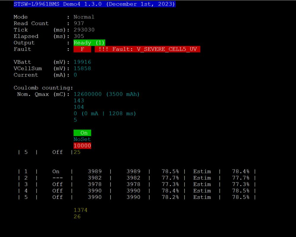

Now I work with the STEVAL-L99615C board and have some problem with it. I don't have an 5-cell board, so I connect charger and all needed saignals directly to the board. The board is configured to work in HS. GUI demo version 2.0.0. Emb. version - 05-11-21-01
When I set the "Charge ON" in GUI - the charging is starting, all works good. But if I want to start discharging it doesn't work. Before turning on the discharge, I turn off the charger. The output voltage on the CH- and CH+ - is battery voltage, but if the load will connected to the output pins then output voltage dropped down to 1.6V.
Also, I tried to run STSW-L9961BMS Demo4 1.3.0. The datasheet says that you also need to use a board, but I don't have one. The program correctly shows all voltages on the cells, but when I connect the load, the program starts to incorrectly show the voltage of the last cell and the corresponding error
