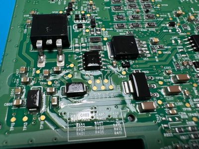

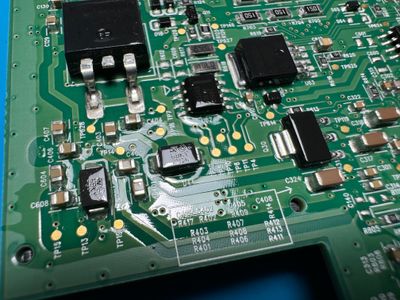

Hi Can anyone id this st device please...Its from a porsche cayenne bms module...vehicle been in a crash and this has blown....
I have id from the another identical item on the board...st-6-6bky z916...
This ive found is coming back as thishttps://www.google.com/url?sa=t&source=web&rct=j&opi=89978449&url=https://www.st.com/resource/en/datasheet/sma6ty.pdf&ved=2ahUKEwiSrozYyrqFAxWwVkEAHYO1D3MQFnoECAEQAQ&usg=AOvVaw1wQO8Fq5stC9C1efemqQeT

 Any help on this would be appreciatted...

The markings have been destroyed along with the component itself - so it's not going to be possible to identify it from that.
You'll either have to find an undamaged one, or look for documentation which identifies the component.
For that, you'll be better off in Porsche and/or EV forums

Hi.
Please circle the items your looking for...if it is the same item i have blown i maybe able to help...
6BKY
SMA6T24CAY
