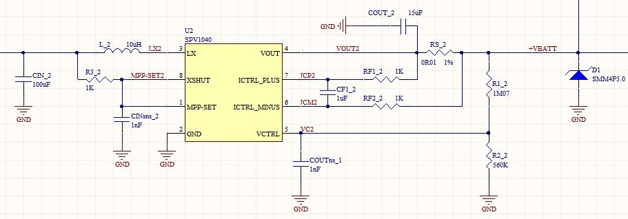

Dear all,
we are noticing breakdown of SPV1040 in our implementation on a board for energy harvesting from solar panel. The breakdown is only for some board. Here you can see the configuration.http://eshop.terms.eu/_data/s_3386/files/1379942540-sunpower_c60_bin_ghi.pdf
in series configuration. For better performance in low-light condition, we introduce a 100nF capacitor in parallel to CINsns_2.When the circuit exhibit the breakdown, we can measure an input impedance on Pin 3 (Lx) very low, instead of about 6KOhm of a working unit. Can this help?Thank you. #spv10402016-04-15 9:48 AM
What is your intended output voltage? I assume that you have already seen where the maximum is 4.8V without the external diode which is not present in your circuit. I expect you would have issues if you attempted to go past 4.8V without that diode. Whether or not they are permanent I can't say.
Where did you find the information to set the values of the resistors? I have been trying to ask ST about this part. On the phone they refused to answer any questions and only referred me to their online submission form. However, that doesn't work.We’re moving the ST Community to a new platform to give you a better and more reliable community experience.
