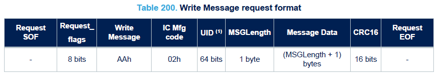

The packet aligns well with the Write Message request format from the datasheet except for the MsgLength and Message Data part.
My understanding is that MsgLength refers to the length of the Message Data and not the entire packet. Based on that understanding, MsgLength value should be 238 bytes and Message Data length should be 239 bytes (MsgLength + 1 byte). However, in the packet above, the MsgLength is defined as FF (255 bytes)

regarding your first question, my reading is that the MsgLength value of 0xFF (255 +1) size matches the 256 bytes of data that follow. If we take your frame:
2026-03-24 10:04:20.785 writeMsg >> 22AA02329411AE665102E0FF08180C180C180C7FF87FF00000000000000000000000000000000003EC0FFC1C1C180C300C30003000300030003000180C1C1C0FF803F0000000000000000000000000000000007FC07FF018381818180C180C180C180C180C180C181818387FF07FE0000000000000000000000000000000007FF87FF818181818199819801F801F8019801998181818187FF87FF8000000000000000000000000000000003FFC3FFC0C0C0C0C0CCC0CC00FC00FC00CC00CC00C000C003FC03FC00000000000000000000000000000000003EC0FFC1C1C180C300C3000300030FE30FE300C380C1C1C0FFC03F0000000000000000000000000000000007E7E7E7E1818181818
2026-03-24 10:04:20.893 writeMsg << 0000
Data block [08180C...181818] is indeed 256-byte long.
For the second example, the MsgLength also matches the length of data that follows: a value of 0x2F means data to follow contains 47+1 = 48 bytes of data. Which is also the case in your example:
2026-03-24 10:12:53.258 writeMsg >> 22AA02329411AE665102E02F08206D617920626520627573792E0A506C65617365206D6F766520746865207265616465722E2E2E0A4F72207265636F
Data block [08206D...65636F] contains 48 bytes.
The confusion may come from counting the MsgLength byte in the data length. It shouldn't be included as MsgLength strictly quantifies the bytes that follow.
We have set a maximum transfer size of 64 bytes for the FEIG MR102 reader in the ST25PC-NFC software, which explains why packets are transmitted differently for this specific reader. STEVAL reader boards (ST25R3916B for example) do not have the same limit.
