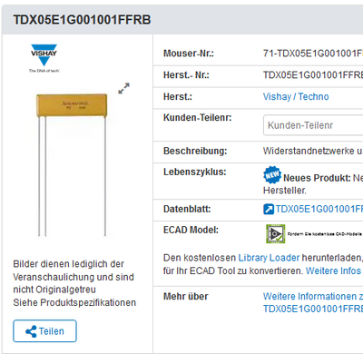

For HV this is "standard"...
here example: 1 Gohm

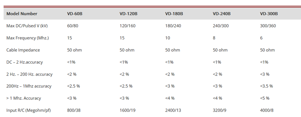

Even the probes for scope are in Gohm range... (i have some here.) :)
-> 0.8 ... 4 Gohm.
These ARE for measuring...only drawback: cheapest is about 3000 $ .

@AScha.3 wrote:Even the probes for scope are in Gohm range... (i have some here.) :)These ARE for measuring...only drawback: cheapest is about 3000 $ .
Very good point (But nothing the 600x difference in the working voltage of those specs vs. OP. And also wondering how often you're supposed to calibrate them). I wonder what engineering lengths they have to go through to maintain accuracy. Those probes must come in those fancy velvet cases, right? like a wedding ring. They probably don bunny suits and wash them with unicorn tears during final assembly ;)
