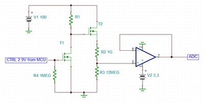

2024-07-09 3:04 AM
You mean a circuit like the one below:
The issue with this circuit is the leakage of the MOSFET and the current consumption through R1. When increasing the value of R1, the P-MOSFET T1 may not turn off completely, and if R1 is too small, it could draw unnecessary current. Could you please recommend some values based on the schematic above?
Or, if I have misunderstood your point, please clarify.

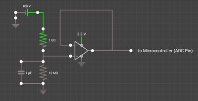

2024-07-07 7:07 AM
Please check your idea again:
It would be better if you could insert schematics as a picture, including the opamp, so that we can make suggestions for improvement.
Regards
/Peter
2024-07-07 8:54 AM
Hi Peter,
Thank you for your feedback. You are correct about the current calculations.
To clarify, R1 is 1GΩ and R2 is 12MΩ. Please find the schematic below for further reference.
Regards,
Zaim
2024-07-07 9:01 AM
Hi Again Peter,
Regarding the voltage divider, the mentioned values were just a preliminary idea. The voltage divider network will only be used once a day to check the output voltage is stable, so it should not consume unnecessary current to help preserve the device's battery.
Regards,
Zaim
2024-07-07 9:35 AM
Peter little mix M and G, but still divider current is around 98nA for your values. Then seems uA current is from MCU and OP. Your point 2 is one step use NFET transistor and remove capacitor.

2024-07-07 9:44 AM
>How can I further reduce the current consumption of this voltage divider to the nanoampere range?
You are there... 100V/1Gohm = 100nA . (100nA x 100V = 10uW - where you wanna go then ?
+ How much uA needs the cpu and all other circuit ? )
>Would switching out the voltage divider using a transistor be a viable solution?
Yes. But to get lower than 100nA, you only could use a mosfet; but at your 3v3 supply, only few mosfets can work at >100V and be switched with < 3V at the gate - so close to impossible.

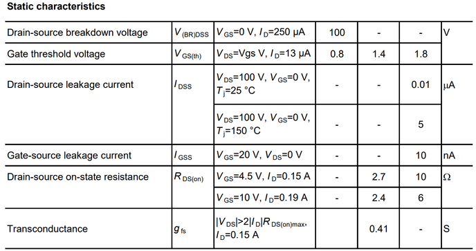

2024-07-07 10:38 AM
I mean 98nA with transistor off can be reduced only to DS leakage current for example BSS123N
and is temp sensitive. Primary reduce other corrents.
