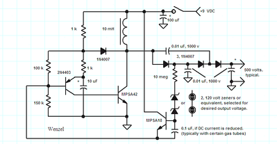

You mean a circuit like the one below:
The issue with this circuit is the leakage of the MOSFET and the current consumption through R1. When increasing the value of R1, the P-MOSFET T1 may not turn off completely, and if R1 is too small, it could draw unnecessary current. Could you please recommend some values based on the schematic above?
Or, if I have misunderstood your point, please clarify.
