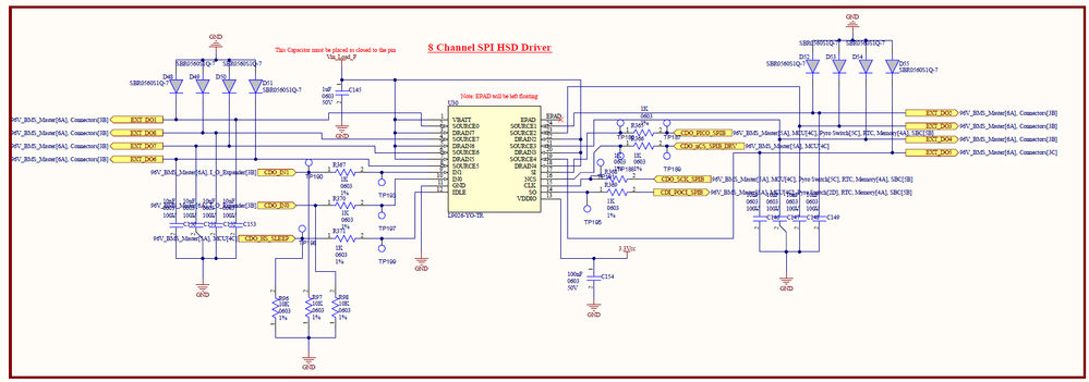

Please show the schematic of how you have the L9026 connected to the MCU.

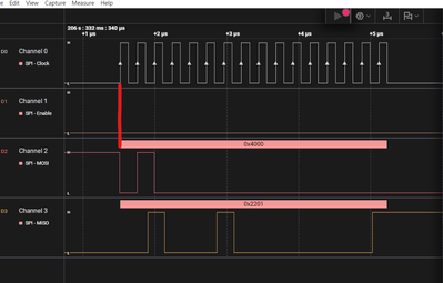

when we are giving (IN0=IN1=0V & IDLE =3.3V ) OR (IN0=IN1=3.3V & IDLE =3.3V), in both cases We are sending data in MOSI ( checking STA1 register- Global Base Address + 0x11) 0x4403 , Slave device (MISO) is responding as 0x2201.

We are getting data in MISO as you mentioned. but It should be correct. We are not able read proper Device id & Status register (Data sent by Slave device (MISO) ).

Your master has incorrect CPHA=1. Data is changing on rising edge, it should be changing on falling edge.

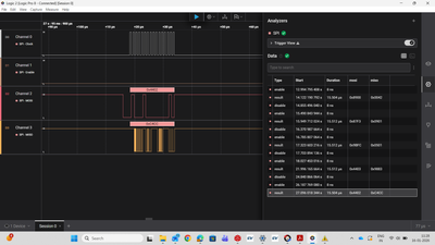

Hi, Thanks for your response. Now L9026 is working. one observation, when we are sending MOSI 0x4403, in MISO response is showing 0xC4CC(1100 0100 1100 1100) . 1 ERR error bit, ‘1’ if an error happened in the previous transmission. What type of error is happening ?
I have attached log & zip file for your reference.

2026-01-16 7:32 AM
Your MISO line has noise on it, look at the plot. The value can't be trusted.
