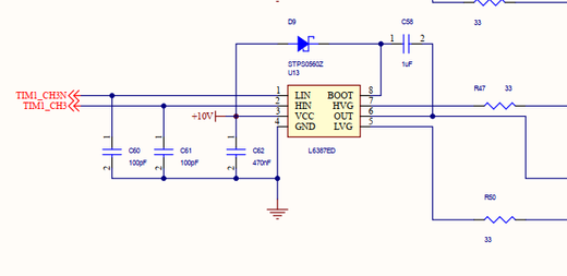

I have seen recommendation for by pass capacitor to be 10 times the boot strap capacitor for Mosfet driver IC's. When i verified the schematics of mb1419-g431cbu6-c01_schematic
The Boostrap capacitance value is 1uF but the By pass capacitance value is 470nF between VCC and Gnd. Request to please clarify.

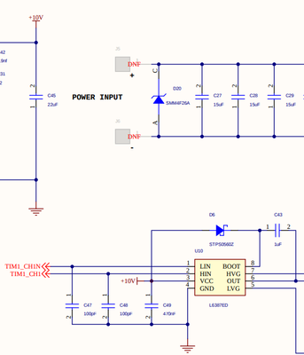

The 10V supply is not finished at the 470n cap....the 22u is next cap:
The 470n just close to the driver to prevent short spikes here.
So total capacity about 20x the bootstrap cap.

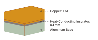

Especially here you have an SMD 120A mosfet , that needs a PCB you have to create, maybe even metal core:
