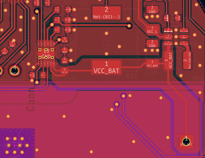

On the bottom picture is STNS01 part PCB layout if needed. Battery is on the bottom. PCB is 4Layered, middle
layers are continuous GND layers.
