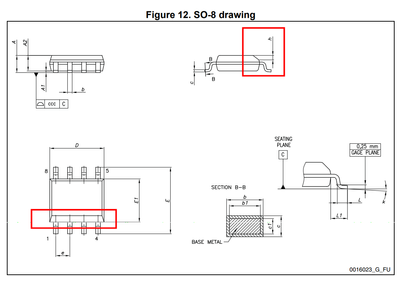

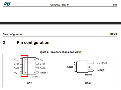

As @Andrew Neil already wrote in your other thread, on this device pin 1 is marked with a chamfered edge. The circle is only an imprint from the ejector during moulding.
Whether the component is original, you need to ask your supplier; this cannot be determined beyond doubt from a photo. If the supplier is one of the authorized distributors, they will be able to give you this information.

As @Peter BENSCH said, the pin 1 position is given by the defined chamfer on the package:
