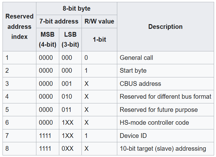

I'm reading the STPD01 datasheet and it states its available I2C addresses : 4, 5, 6, and 7.
Reading to general I2C documentation, it seems that these addresses are reserved to I2C HS-Mode.
So, is STPD01 an HS-Mode controller or a regular (100kHz) device?

The (8-bit) addresses 0x00...0x07 mentioned in the I2C specification (e.g. found on Wikipedia) refer to the complete (8-bit) address, including the 4 MSB as well as bit 0 (R/W). However, the address range of the STPD01 is defined by the bits specified in the data sheet, section 7.12.2, where bit 2 and bit 1 can be freely chosen by setting the ADD1 and ADD0 pins to the corresponding level. Since bit 0 only determines the data direction from the host's perspective (Read/Write), only the upper 7 bits are simplistically called the "address," which for the STPD01 lies between 0x00...0x07 (7-bit), corresponding to the 8-bit address range 0x08...0x0f. As correctly identified by you, the STPD01 can therefore be addressed with the 7-bit addresses 4...7.

Thanks for the complete reply, but I still have a doubt. Assuming the common convention "the upper 7 bits are simplistically called the "address" (used also in the Wiki article), if I properly interpret the following table (extracted from wiki), the 6-th line tells that addresses 0x4 to 0x7 are reserved for HS-controller code. As you stated, STPD01 doesn't support HS, so I still don't get why this chip stays in this range.
I know Wiki is not the source of truth, but as I previously linked, many relevant players state the exact same knowledge.
To be clear, I'm just trying to figure out if it is a suggestion or a strict rule, and maybe I'm misinterpreting something.

Well, the STPD01 is not an HS-mode I2C device, but a Fast-mode slave device and supports clock rates up to 400kHz only.
The address range 4 to 7 stated in the data sheet refers to the device’s 7-bit slave address configuration via the ADD0/ADD1 pins and is valid for this device. Generic reserved-address tables describe the I2C protocol in general, but they do not supersede the device-specific addressing information given in the data sheet.

The address ranges 0x04...0x07 specified in the original I2C bus specification UM10204, from which the Wiki copied the table, were or are not to be understood as a blanket prohibition for all I2C devices, but rather as a reserved address range with a specific purpose, typically for high-speed-capable bus participants or controller configurations. UM10204 mentions this in section 3.1.12:
If it is known that the reserved address is never going to be used for its intended purpose, a reserved address can be used for a target address.

The statement you cited is what I was looking for: an official third-party declaration that allows to escape from the reserved I2C addresses table. And, unfortunately, I didn't read the NXP UM10204.
