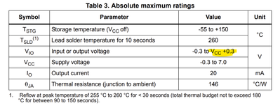

2026-05-21 9:09 AM
@Peter BENSCH, can the /RST pin have a pull-up to supply that's present while the VCC the device is unpowered? Typically that's OK for open-drain outputs, but the datasheet shows a max input/output voltage of -0.3 to VCC+0.3, which is odd.
2026-05-26 12:30 AM
No, with a few exceptions, that is entirely typical for integrated devices. In the implementation of the internal function using semiconductors, parasitic pn junctions also arise. Under normal operating conditions, these are reverse-biased; however, if the operating voltage is exceeded or falls below the required level, they act like ordinary diodes. For this reason, going above or below this level must be limited (here 300mV) in order to remain below the forward voltage.
Regards
/Peter
